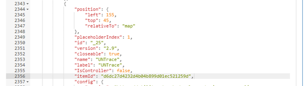

@Anonymous User , yes theoretically you can add a new widget location.
In the json there is a position location for the widgets in relation to the map, so you can add a new widget location. You would need to follow the spacing sequence when adding the new widget. Below is an example of what the json looks like.

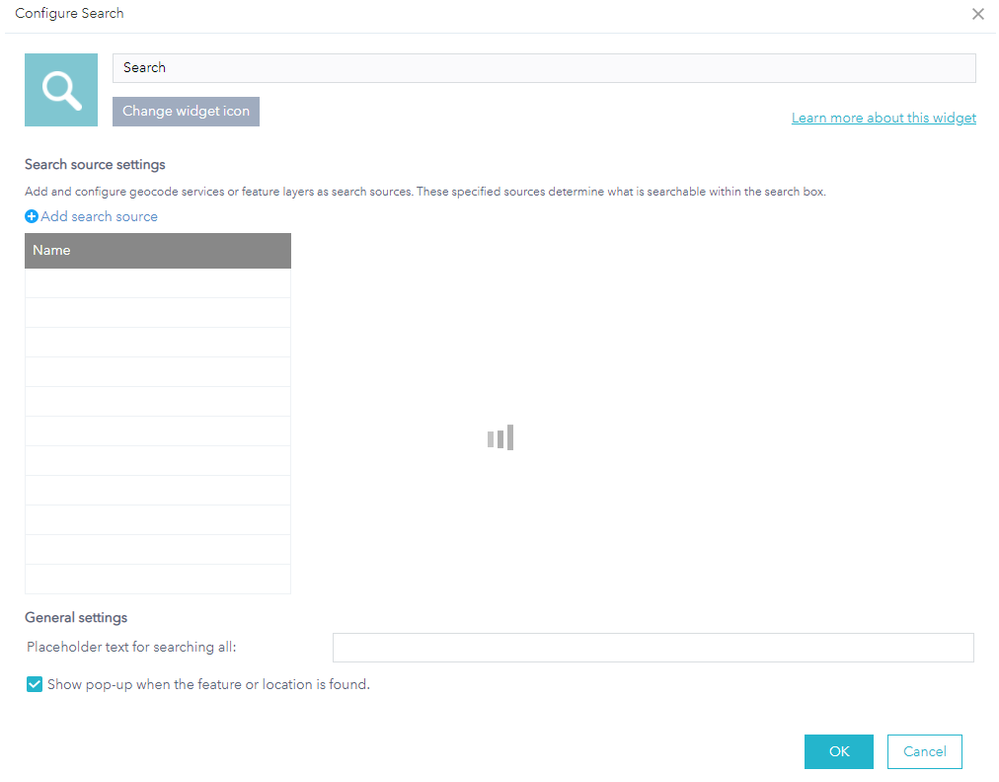

The search widget disappeared from Web App builder - Launchpad Theme. Normally, the search widget was located on the header. I can see it in the controller tab however, WAB doesn't allow me to configure the search widget. I removed the feature layer from the map that was connected to the search widget. Could that be the reason why it's missing? I intended to connect it to a new layer however, I have no control over the search widget now. Any thoughts?

GeorginaScholes
Hi @Anonymous User
Did you ever figure out what the problem was or find a solution? I have a similar issue.
