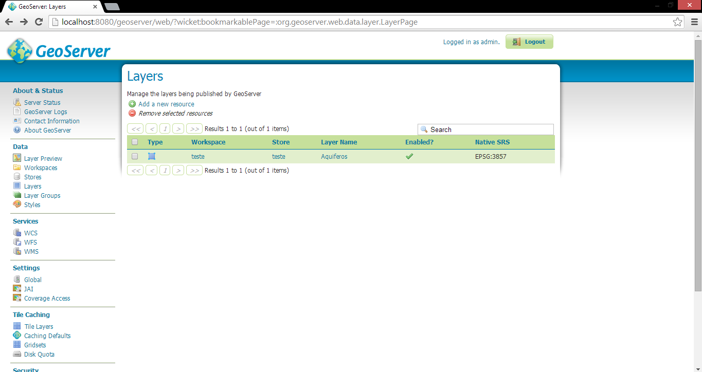

Here is my service:
And here is the result:

Ricardo,
try typing http://localhost:8080/geoserver/wms?request=getcapabilities in your browser this should provide the capabilities for the wms, in here you will see the layer name you will need to use. It maybe be teste:Aquifero
you will not see any attributes in your attribute table as this is not supported for wms layers
