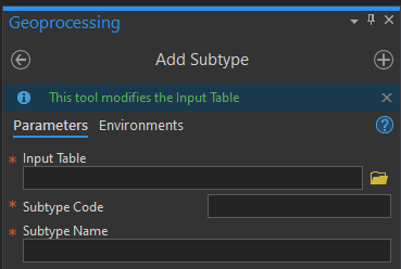

Hi Luca.  I think I answered a similar question this morning.  Maybe take a look to see if it's what you need?
https://community.esri.com/t5/arcgis-utility-network-questions/how-to-define-domains-while-using-sub...

Luca_Schikowski
Hi,
no, that is not working for Subtype Group Layer. Those layer dont even have the design -> subtype menu as you mentioned...
