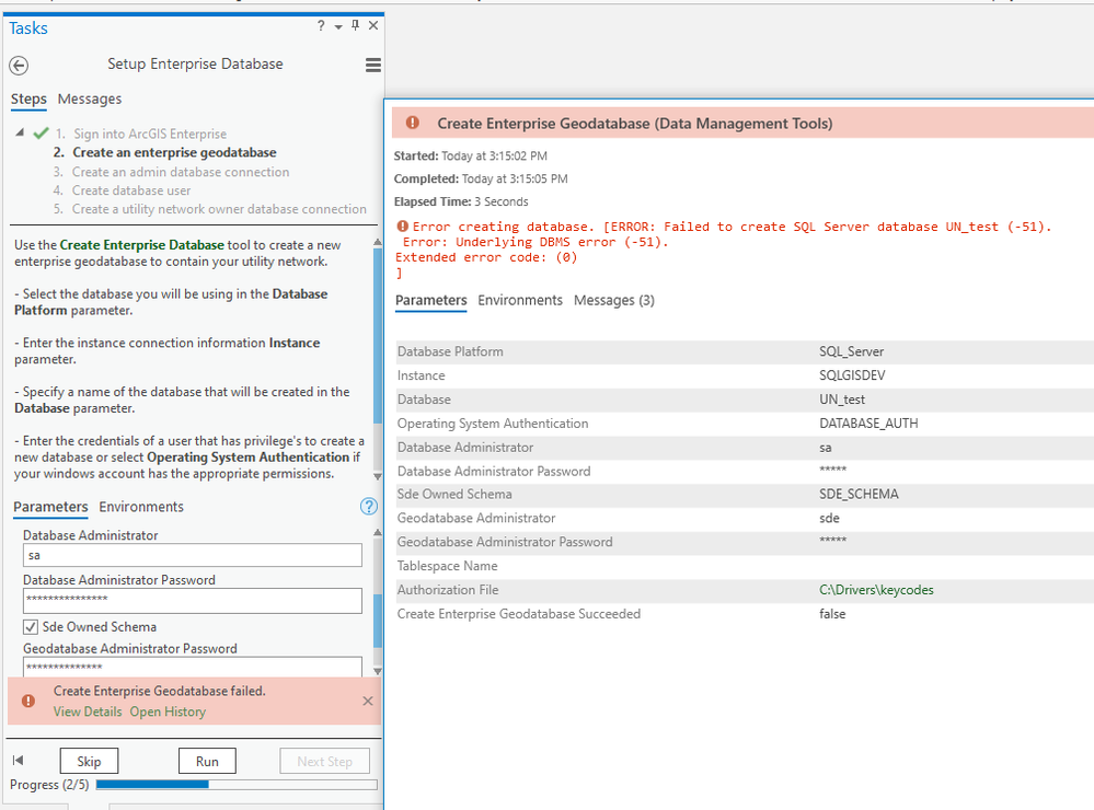

Hi, we just recently staged the 10.9 Enterprise on dev server, and we are trying to create a geodatabase which is planned to deploy Utility Network. We use SQL as datastore, and came accross following error message. Anyone with similar experience and solution?
Cheers,
Song

What version of SQL are you using?  Min version is 2016 and I do not believe Express is supported by the Utility Network.
ChestonDobbins
Are you able to capture any additional error logs, or maybe a SQL Profiler trace of the database error?
Also... what version of ArcGIS Pro is being used?

Here is the version informaion:
ArcGIS Pro 2.8.0 is used from my computer
on the server there is SQL Server Enterprise 10.9 and Geodatabase 10.9.2.8;
SQL version: Microsoft SQL Server Developer Edition (64-bit) 13.0.5865 SP2
There is no connection issue and I don't know how to locate error message on the database side.
