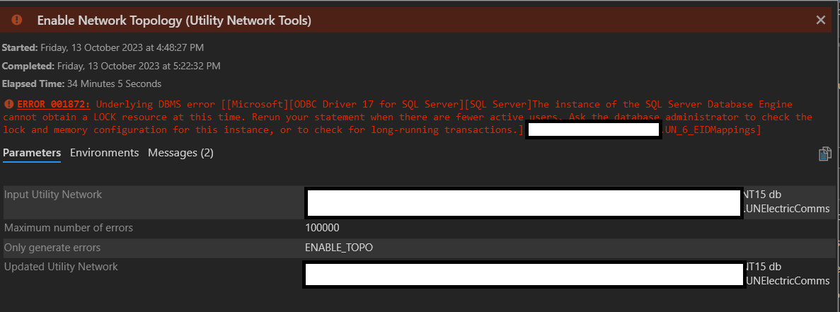

When I try to run Enable Network Topology I get this error consistently.
ERROR 001872: Underlying DBMS error [[Microsoft][ODBC Driver 17 for SQL Server][SQL Server]The instance of the SQL Server Database Engine cannot obtain a LOCK resource at this time. Rerun your statement when there are fewer active users. Ask the database administrator to check the lock and memory configuration for this instance, or to check for long-running transactions.] [XXXXXXXXXX.NETADMIN.UN_6_EIDMappings]

AnthonyRyanEQL
Have you check the geodatabase connections to see if any users have connected to the geodatabase, closed all ArcGIS Pro clients with an sde connection to the geodatabase, services still running, etc?
I have found in the past having ArcGIS Pro open with an sde file to the geodatabase can cause a lock. The way I run enable topology is via a python script and don't get any issues like this anymore
RobertKrisher
This looks like it could actually be a lock escalation issue on the EID mapping table. I'd recommend you reach out to support and reference this knowledge base topic: Bug: Branch Versioned Editing May Encounter Locking, Blocking, and Deadlocking When the Da (esri.com.... If it is a lock escalation issue then they can provide a workaround, although if you're applied all the latest utility network patches to your ArcGIS Pro client and ArcGIS Enterprise install then you shouldn't be running into this issue.
