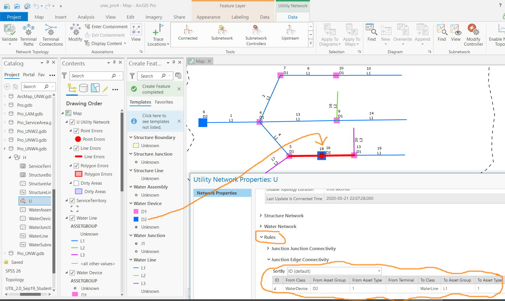

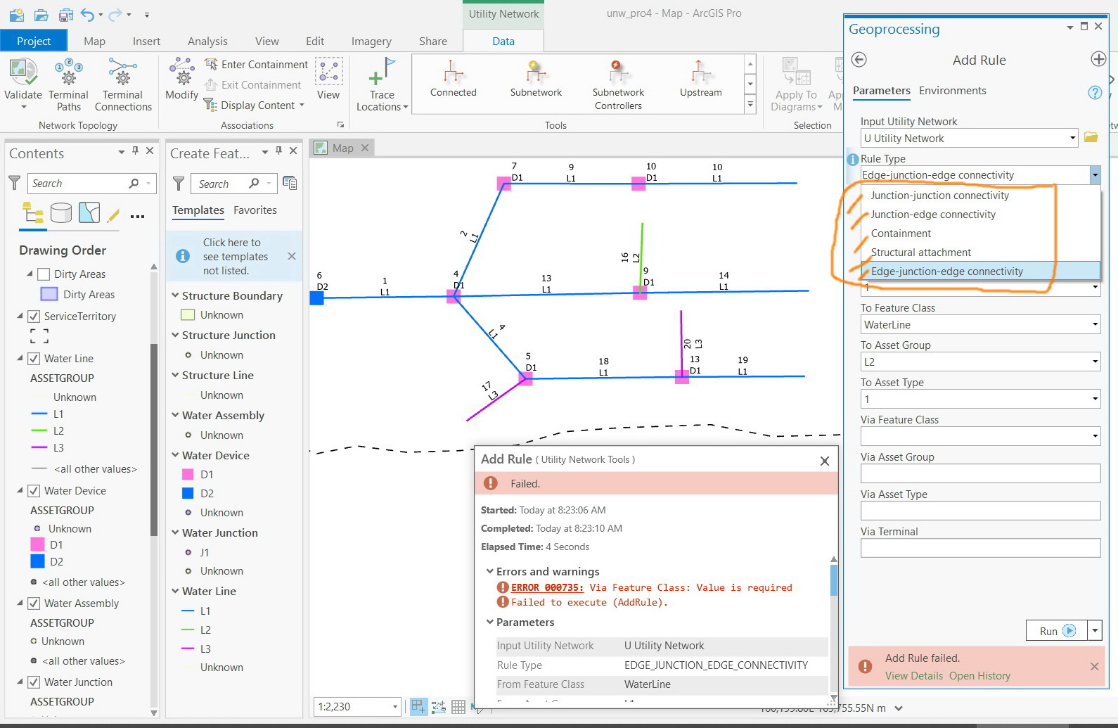

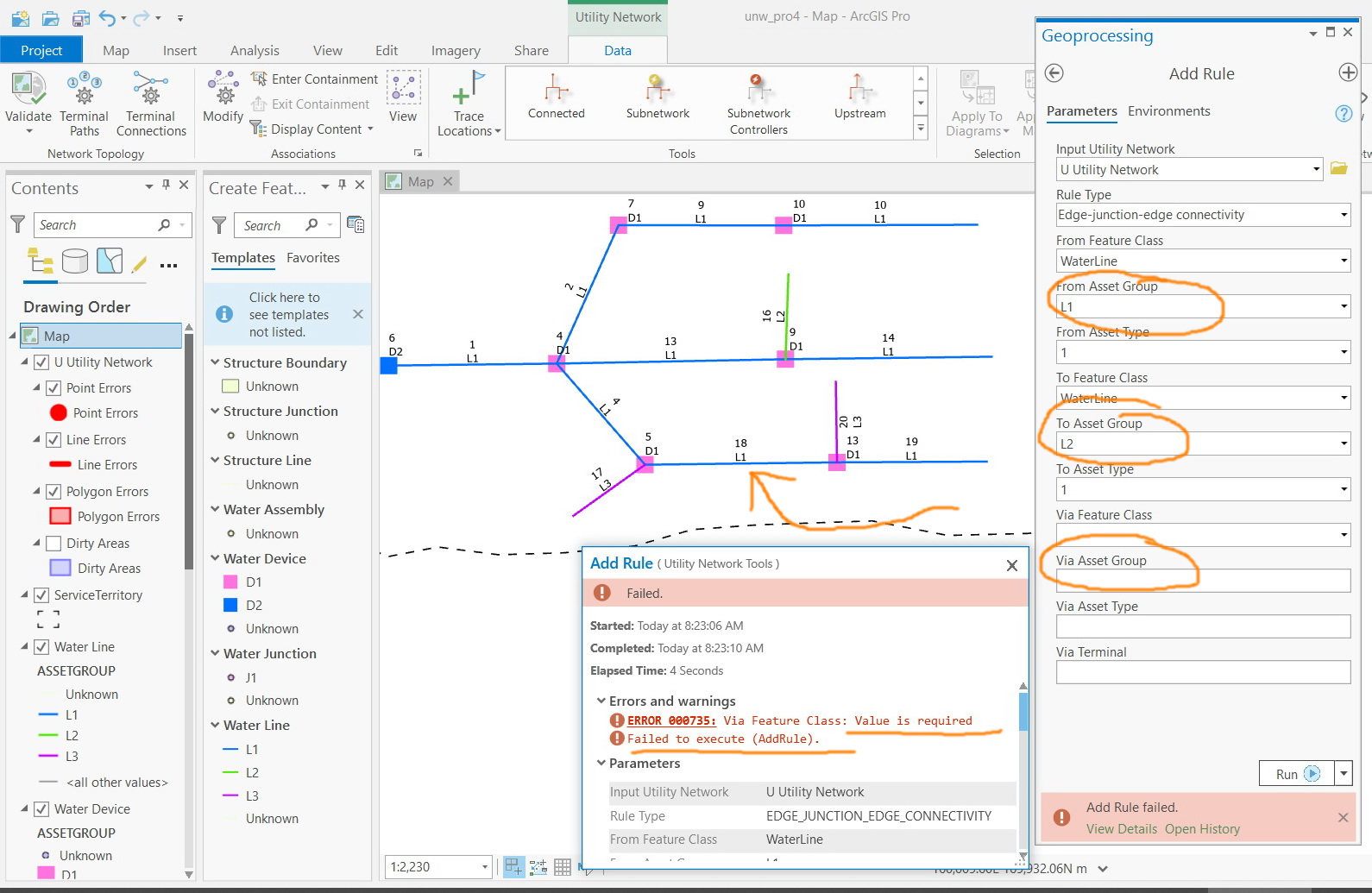

For example, in the screenshot below, I wanted a rule that allow L2 to be connected to L1 anywhere along its edge without the need to have junction, device, or assembly. How this rule can be configured?
In the 3rd screenshot, despite the fact that there is a connectivity rule between L1 and D1, plotting D1 along the L1 edge considers as rule violation!

You cannot. If two edges are connected at a vertex, they must have a point feature also coincident if the edges have different asset group & asset type.

Then why I’m getting point and line errors as a device (D1) is plotted along (L1) edge despite the fact that there is a junction-edge connectivity rule between L1 and D1
What could be the issue here?

Here the issue is different. The rule between line (L1) and device point (D1) is configured, nevertheless, errors are identified
What might be the reason?

Looking at the last Picture you sent I would conclude the following:
The line must have a vertex at the same spot as the device/junction is set. They must be coinsident (X,Y,Z).
The "Midspan Error" on line can mean "between the vertices".
Working with the rules:
If you have the rule and set the device/junktion a vertex is created on the line.
If you have the device and the line and make the rule no vertex is set on the line.
See the link Paul LeBlanc‌ sent. first lines reads:
There are two locations where point features can connect to lines: an end point and a midspan vertex. Each asset type in the domain network is set with a default edge connectivity setting.
Hope this will help you.

In the screenshot below, the device D1 is digitized on top of a vertex of Line L1, nevertheless, the “midspan connectivity not allowed” error persists to exist.
What other issues might I need to check?
