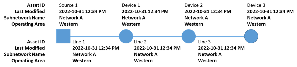

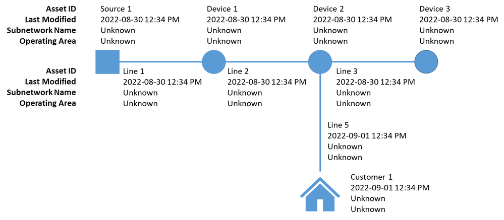

The first example we’ll look at is something that every project does at least once. Running update subnetwork on the default version in a brand-new database. In this case, all the subnetwork name fields in the database have the value ‘Unknown’ and the rest of the fields have their initial values from the data load. You can see an example of this in the graphic below.
Figure 1 Initial database state
After running update subnetwork on Network A, we can see that the subnetwork name field has been updated on all the features in the subnetwork, but editor tracking and attribute rules were not triggered during these updates. If any of our classes had feature-linked annotation the annotation would not be modified during this event as well.

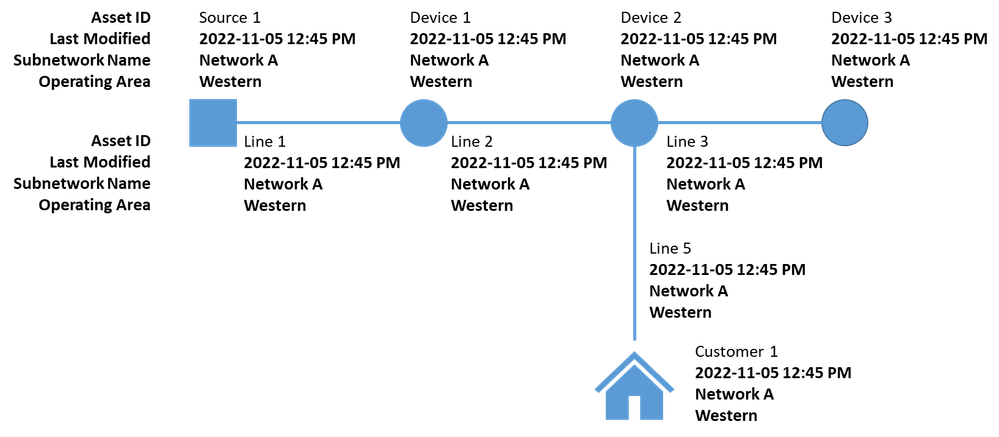

Our first example builds on our previous example. Let’s assume we have a database with no subnetwork information populated, and before running update subnetwork in default we decide to create a new named version and add a new service in that version. Here is a graphic of our newly created features in our version before running update subnetwork:
Figure 4 New features created in a named version
After running update subnetwork without eventing in the named version, you will notice something curious. Only the features that were created in this version get their subnetwork name populated.

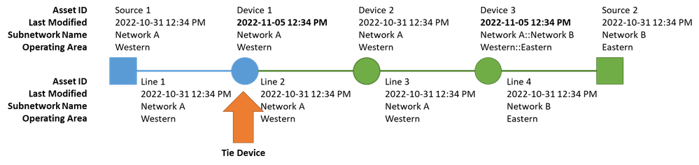

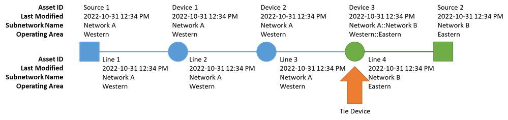

In this example, we will be changing the tie device between the subnetworks from device 3 to device 1. This happens quite frequently in the real world as circuits, pressure zones, etc. are reconfigured to account for long-term or even seasonal changes in customer demand. To do this we change the status of these two devices to indicate their new open/closed status so that Device 1 is now a tie device and Device 3 no longer acts as a barrier.
Figure 7 Updated tie device
We see these changes reflected in the diagram above because the tie device indicator moved from Device 3 to Device 1, the last modified date is updated, and we’ve updated the coloring on the features to visually indicate which subnetwork they belong to if you were to trace each subnetwork. The subnetwork names are still showing their old values because we haven’t run update subnetwork. Below you will see a diagram that shows all the attribute changes that will occur when update subnetwork is run under these conditions.
Figure 8 updated subnetwork in named version
As expected, we see that the subnetwork name field on both the devices that we edited in this version is updated. However, the features that were connected to Network A but are now connected to Network B still have the old subnetwork name and operating area values. Because these features weren’t edited in this version update subnetwork can’t edit them without triggering edit events.
