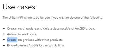

Ha, I can see that I need to read about the Urban API.

Thank you for your question! The short answer is that adding spaces in ArcGIS Pro is currently not supported. If you would like to add spaces in an external tool, please have a look at the ArcGIS Urban API.
The long answer:
  • Spaces in ArcGIS Urban are stored as 3D polygons (with a z-coordinate), this means that editing in 2D will not work. However, I strongly advise against editing Urban data directly in ArcGIS Pro because this most likely will lead to broken data.
  • If you would like to add spaces from an external tool, please have a look at the ArcGIS Urban API  (which you already discovered). There is an operation called createSpaces() that lets you add spaces. If you have questions about the Urban API, please have a look at the documentation or the Urban API Place in the Esri Community.
