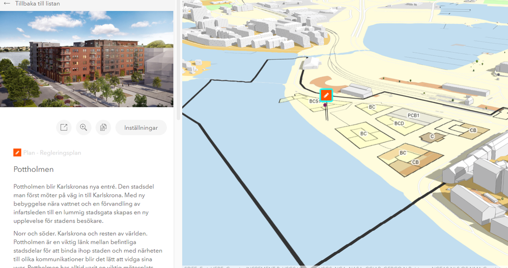

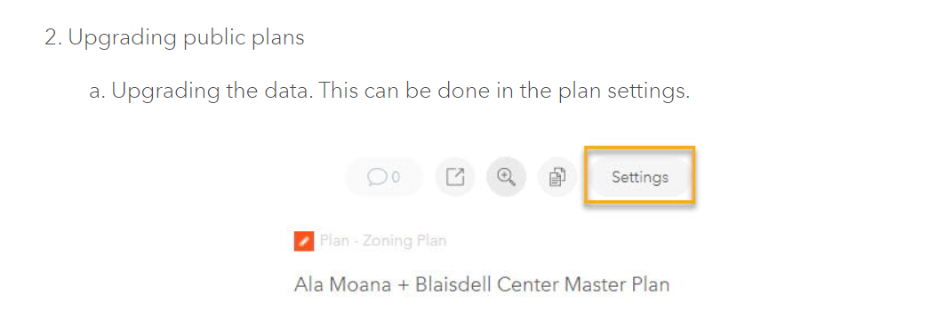

Hi Everyone,
I followed the guide from the blog post and have followed all steps up to this point.
After updating I can't edit my plan anymore, as there is no way of getting into edit mode. I can see the zoning areas of my scenarios, but no buildings.
Thanks in advance for any help regarding this issue. 🙂
/Max

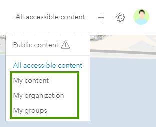

1) Filter the urban overview by using the content scope switcher so that it doesn't show public plans and projects - choose from any of the options highlighted in the green rectangle as shown in the screenshot below (depending on the sharing settings of your design). Open the design plan detail card. There you will be seeing the "Open" button 🙂

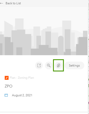

2) In case you don't have access to the original design plan or maybe accidentally deleted it, create a new design copy from the public version of your plan, by clicking the "Save As" button on the public plan detail card.

MaxNilsson
Hi @DominikAllemann
Thanks for the reply.
Option number one doesn't work for me as I can't see any other plans except ones that are "Public". They are old plans that were created before Urban design plans existed as items in AGOL(?). The only existing version is the public plan.

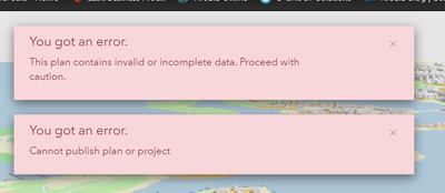

Option number two should be the answer to create new design plans that I can edit however I get this error message:
Even if I get this error, the design plan gets created, but no corresponding plan inside ArcGIS Urban. The feature layer that gets created is empty of data.

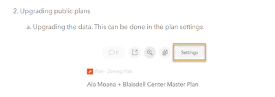

I have opened the plan settings and updated everything there when prompted.

MaxNilsson
The plans were created early 2020 so that might be the issue then.
I did manage to successfully upgrade the plans to my understanding and there were no particular error messages displayed. Urban did crash when updating one or two times but it worked when running the update again. There are no longer any available upgrades to be made in either the plans or the urban model settings.
Here is the logfile after having run the "Save as" command in Urban. I'm using Chrome.
