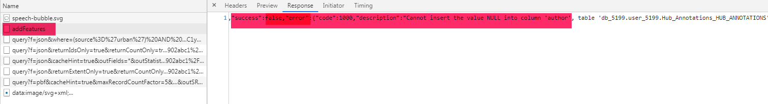

3) When a public comment is added in Urban interface, the response to the corresponding "addFeatures" request is :
"success":false,"error":{"code":1000,"description":"Cannot insert the value NULL into column 'author', table 'db_5199.user_5199.Hub_Annotations_HUB_ANNOTATIONS'
Hub annotations feature service is managed by ArcGIS hub : by design, there is no default value for "author" field, and Null values are not allowed. Behaviour is the same if logged in AGOL.

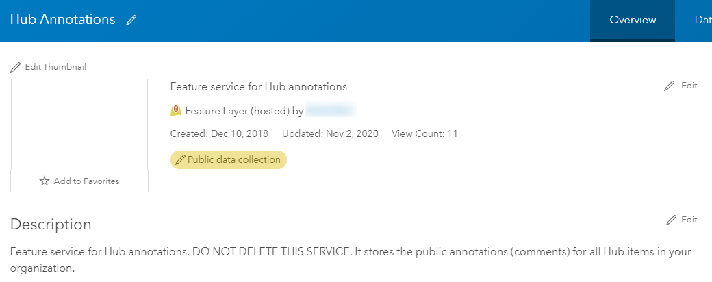

The data model of Hub Annotations layers was slightly changed before the first release of ArcGIS Urban in July 2019. Based on the screenshots you've shared it looks as if your Hub Annotations layer was already created in 2018 - i.e. it doesn't include yet the Urban specific changes to its data model.
