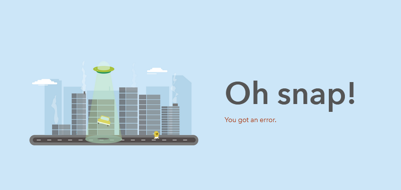

Hello.  The past couple weeks I have been using Urban through a trial, and yesterday when my company officially purchased both GIS Professional Basic & ArcGIS Urban Suite licenses I am now unable to open an Urban Model I had previously been working on in my trial period. Every time I attempt to open my model I get the following message:
Additionally, I am also unable to create a new Urban Model from a template or from scratch.

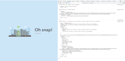

Could you post a screenshot of your browser console log once the error occurs? (Hit F12 on your keyboard and click on "Console" in the right side panel).
> After looking at this, I find it very interesting that the message says "Services are currently in read only state. Writes are not permitted."

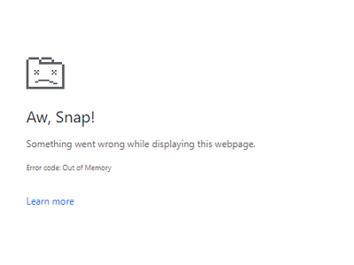

AlexRudowski
Hi @AugustNastasi and @Till_Schmid ,
I'm having the same issue with browser crashes when I try to load Urban. I also have sufficient admin privileges and plenty of credits. Can you share what tech support's solution was?
