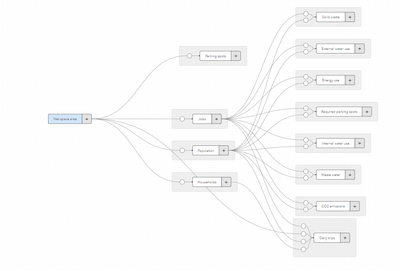

Hey Senad!
For the metrics, we usually recommend using them with the Plans section, because the metrics themselves will be generated based off of the space uses you use. However, the projects can again use the metrics if you have those numbers already!
For the metrics, I took a screenshot of the metrics graph, and from there you can add metrics either at the top, or add them directly from an existing metric (i.e. I can create a metric called "Affordable housing", that is acting off of my "Households" metric).
For the Web Scene question, you can yes! I would recommend if you want to use the pop ups options is to load them in as Indicators, where you can enable pop ups!

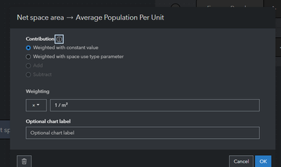

SenadHodzic1
Hi Silvia,
Thank you for answering. We currently purchased it and as I've played around with it and researched some more I've come to realize that. To give you an idea, my planning department does not want to use or create the buildings within ArcGIS Urban and we in GIS department don't have the resources to dedicate to creating the buildings. Additionally, we dont have any of the zoning, space use, land use types set up so we can't utilize most of the function. This is why i've created 3D buildings from our developers and created a Web Scene as a Background/scenario for each "Project" (which is actually each development application). That way we still see 3d buildings and manually input the metrics which i do by assigning a constant factor of
"times 1" and the unit measurement if applicable. see the image i've shared. It isn't exactly ideal, but it gets the job done.
