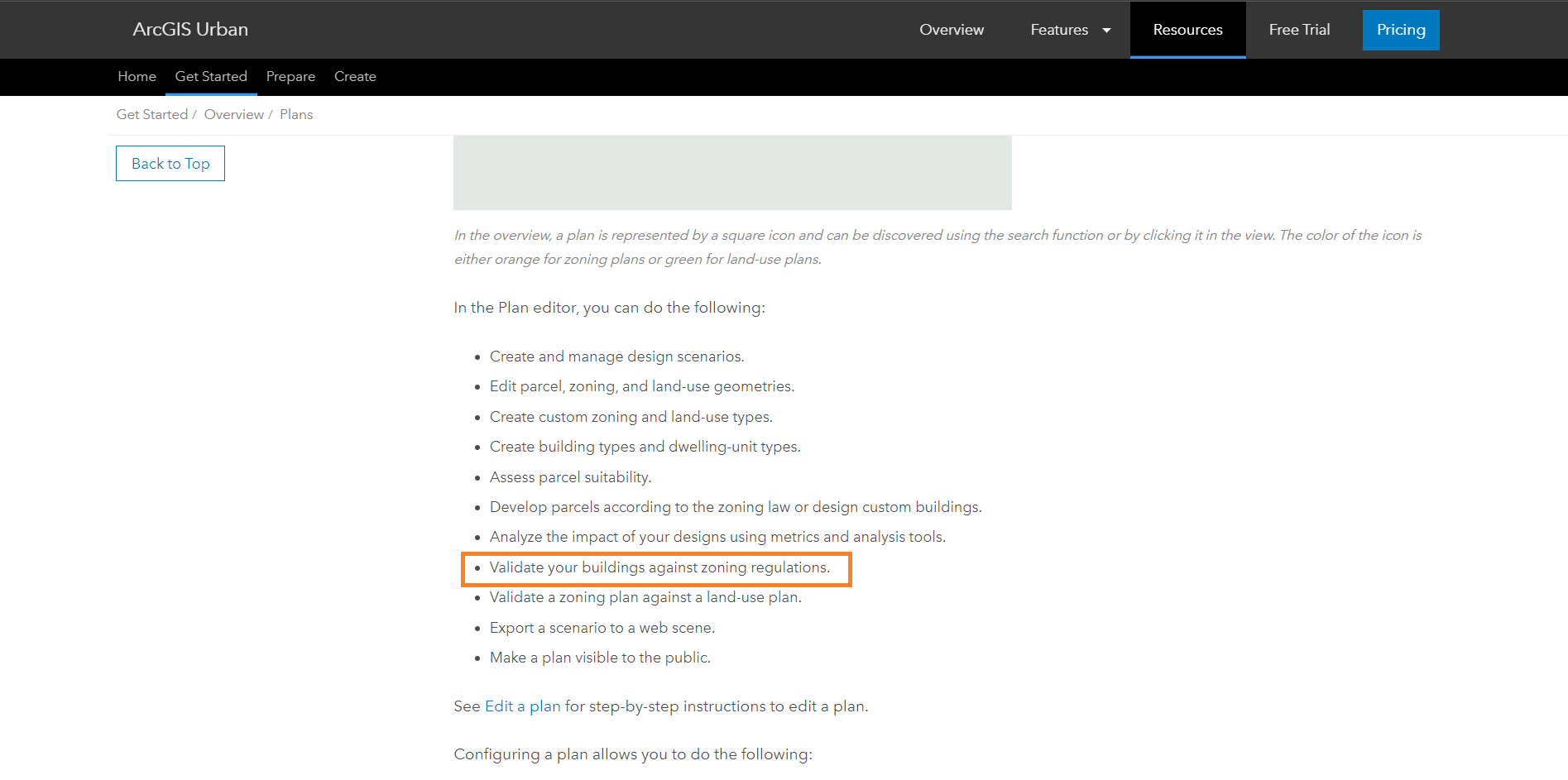

Hello,
I am new to ArcGIS Urban. I am wondering how to validate the building types against zoning violations.
It is mentioned in Plans—ArcGIS Urban | Documentation
that you can use plan editor to validate building types against zoning regulations but didn't mention how to do that and I searched online but didn't find anything.
I hope you can help me.
Till_Schmid
Thanks for your question @MohamedG!
Buildings can be validated against zoning regulations in two ways:
  1. By turning on the warning labels layer in the hamburger menu in the top left of the header. Buildings that violate zoning regulations will show a warning label. On hover, it shows additional information.
  2. When you select a parcel, you can check built and allowed parameters in the right side panel. Parameters that violate what it's allowed, are showing a dot.
See the screenshot below for more information:
