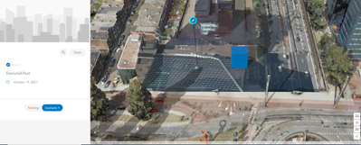

I have noticed once a project has been made and the scenarios have been created with detail, concrete textures, trees cars etc. The detail is not visualized if the project is not opened. It is also not visualized when the project is published so that people can review it and give feed back.
It would be nice if the scenarios would immediately be visualized with all their detail in the published versions of the projects and also before they have been opened.
Here is a example of a project that has not yet been opened, the detail is not visualized.

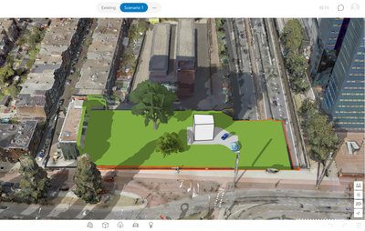

Here is the same project that has been published, the detail is also not visualized.
Here is the same project after it has been opened with the detail visualized.
