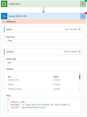

This might not be your issue, but I'm hoping this might help others who are experiencing this error.
Based on my past experiences with this error, it was due to the fact that the report was not generated, resulting in that error since there was no report to upload.  While Survey123 showed it passed and did not fail, it technically failed.  Most often than not, it was due to a missing token due to my Survey123 connection expiring after 2 weeks (organization policy).
Check your Survey123 create report raw output to see if it says esriJobSucceeded.  If it does not say that, then your report was not generated.  See my screenshot where it shows it passed, but no report was created for it to upload.
I hope this helps out.
SeanNagy1
You appear to be incorrect in that a report was not created even though it  showed no error. How do you correct the Survey123 connection expiring without recreating the entire flow?
RobertAnderson3
MVP Regular Contributor
The Survey123 token that's used for the Create report action times out every 14 days currently, have been pushing Esri to update this but they have to work with Microsoft so it's a slow process (they have recently updated the ArcGIS Online connection to remove this limitation)
To refresh your connection, click Connections on the side of the screen, then find the Survey123 one and click Switch Account and then just sign in again with the same credentials. And set a reminder to do this every 13 days until Esri improves this.
