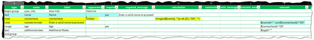

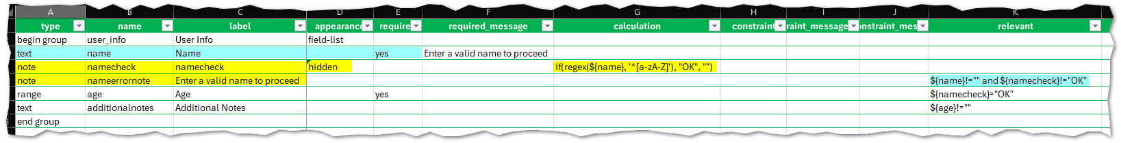

    Here is a simplified example:
    typenamelabelappearancerequiredrequired_messagecalculationconstraintconstraint_message::defaultconstraint_messagerelevant
    begin groupuser_infoUser Infofield-list
    textnameName yesEnter a valid name to proceed
    notenamechecknamecheckhidden  if(regex(${name}, '^[a-zA-Z]'), "OK", "")
    notenameerrornoteEnter a valid name to proceed       ${name}!="" and ${namecheck}!="OK"
    rangeageAge yes     ${namecheck}="OK"
    textadditionalnotesAdditional Notes       ${age}!=""
    end group
