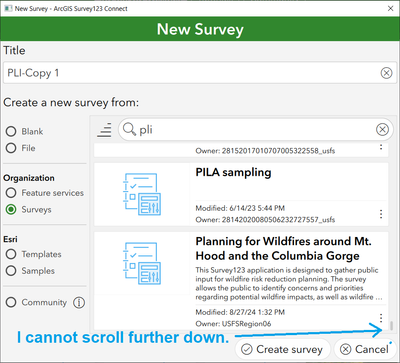

My organization is fairly large and there are many surveys and feature layers for our many programs.  When I try to create a new survey from an existing survey or an existing feature layer, the list of available items is never complete.  Only items in the first part of the alphabet are shown.  I sometimes have to name my items with a 0 or 1 at the beginning so that they will show up.  If I don't own the item, and it's too far down the list, I can't use them.
New survey window in Connect version 3.20.63  The list of surveys stops here.New survey window in Connect version 3.20.63 The list of surveys stops here.
Any suggestions?  I vote for putting in a filter or expanding the number of items Connect can display.

Get the itemid of the layer from ArcGIS online and search for that in connect?
abureaux
MVP Frequent Contributor
Does it search by itemId? I didn't think that it did, but great if it does.
Beyond itemId, you could just provide more of the name to shorten the list.
And beyond even that, this sounds like a good topic for the Ideas thread.
BethanyCrenshaw1
Thanks.  Good idea.  I tried the complete exact name but no results showed up.  Connect is still just looking at the first part of the alphabet.  I'll try the ideas thread.
BethanyCrenshaw1
Thank you.  Good thought.  I tried various versions o fthe item id it to no avail.
