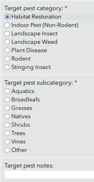

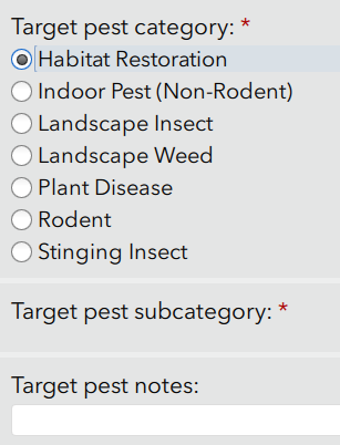

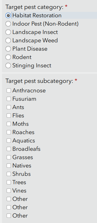

I need to change the type of the conditional question ("Target pest subcategory") so that more than one can be selected:
However, the filtering does not work when I change the type from select_one to select_multiple:
QA (TargetPestCategories) references 7 options from the 'choices' sheet (image below). 3 of these options have subcategories that are within another list referenced by QB (TargetPestSubCategory).
QB contains a relevant query...
selected(${TargetPestCategories},'Plant_Disease') or selected(${TargetPestCategories}, 'Indoor_Pest') or selected(${TargetPestCategories}, 'Habitat_Restoration')
...and a filter:
filter=${TargetPestCategories}
This is what the survey looks like when I remove the filter:
Any ideas how I can filter the conditional question while still allowing for multiple selections?

BrandonArmstrong
Hi Alexa,
Unfortunately, cascading selects are not supported by multiple choice type questions. We do have an open enhancement request for adopting support in a future release, which I will add you too.
