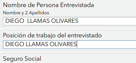

Hello,
I have been doing some test with caplock for my text fields in survey123. I was able to do it.

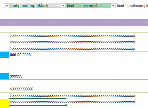

In Esri:inputMask y add this symbol > and xxxxxxxxxxx for the quantity of letters we think we will be using
We write with spaces in survey 123

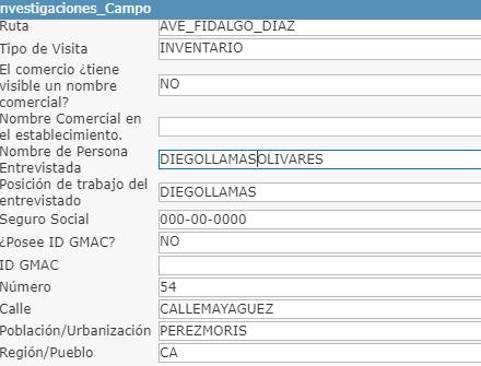

But when we see the info on a map we can see the info but with no spaces between them
If we open the survey we send we see the same behavior. No space between words
I asume it is because in Mask we do not have any space between x but we do not have control what the user is going to write, so, my question is How can we have caplock for words and respect the space we put on them? is it possible?
>PLEASESAYYES
Thanks for your help!
Diego Llamas

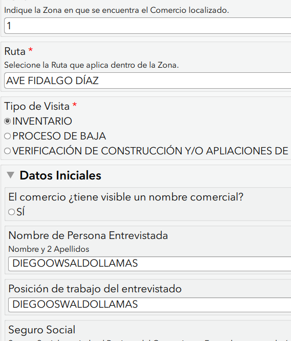

I tried your suggestion adding regex to Constraint column.
But when I was doing some test my letters did capitalize and I got an invalid error
Now I know that Mask option will not help me to capitalize automatically the letters people writes in text fields.

Hello Brandon Armstrong‌ maybe i didn't explain my self clearly. What I want to do is, even though my users use  lowercase to write in my text fields in my survey, I want that automatically the letters are capitalized. Using this symbol (>) with certain number of x (>xxxxxxxxxxxxxx) in esri:inputMask field I was able to do so. all my letters are capital letters but because in mask field I used >xxxxxxxxxxxxx.... with no space, all my word get together because in Mask there aren't any space.
what I want to know is, if it is possible to survey capitalize all my letters when I write something using lowercase and respect the spaces between words. As I said. I was able to capitalize letters using >xxxxx... but this does not respect spaces between words.

Unfortunately, Input Masks cannot be used to accomplish the honoring of dynamic spacing placed in the input.  You would need to explicitly define the placement of spaces within the Input Mask.
