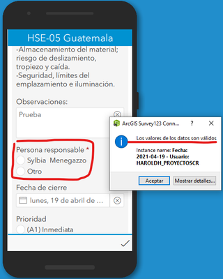

HaroldHerrera1
Hi @Anonymous User  Do you have any notice about this Bug-000120023? In our case, the question with Relevant statement and Required=Yes don't work...
Survey Connect Version 3.12.232
Survey App 3.12.277
by Anonymous User
Not applicable
Hi @HaroldHerrera1,
BUG000120023 was fixed in the 3.5 release. It is possible the issue you are seeing above is a slight variation of this issue, or there is another cause.
Can you please share your xlsxform so we can take a closer look - also if you use any CSV or media folder files, also please provide them too.
Regards,
Phil.
HaroldHerrera1
Hi Philip,
Many thanks for your answer. I found my mistake, fixed and everything looks good.
