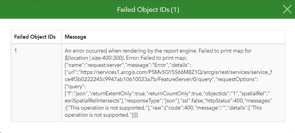

Hello @Jim-Moore @JodyZhengLiu. I have a similar problem. I created a survey in Survey123 Connect and change the basemap so the field personnel can use reference information. The basemap is loading a map using a service in Enterprise. I checked the options of the service and I see export options are supported.
I have tried changing the scale and I have used mapSettings and Map with different options. Is there anything else I could try?  Thank you.
PetronilaMandeno
So, I guess this is a regular error. I remember getting this error before and was able to fix it, but now I can't figure out a new error for a new report template.
Here's the error I get:
Any clues?
