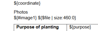

Firstly, when I download the Individual report sample template there are just a few fields parsed to the report - many in the survey are not parsed.

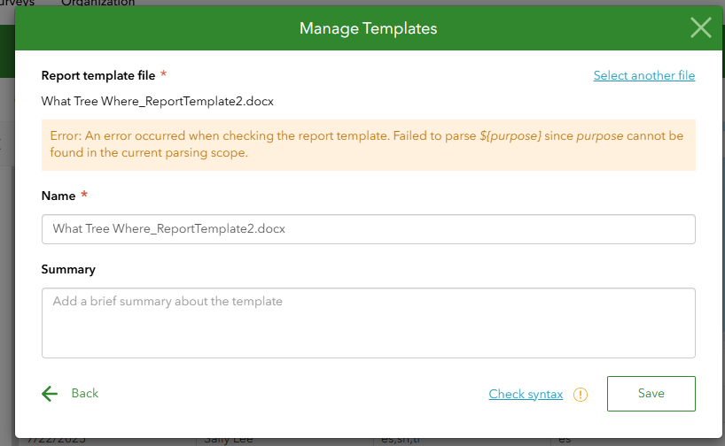

Secondly, I edited that file to include all the fields I want in the report but when I try to select that template document I get the following error message:
'purpose' is a field in my survey (choice list also named purpose). As with previous posts from 2019/2020, if I remove ${purpose} from the template it moves on to error on the next field.
I've included my formatted xlsx, the report sample template and the edited template.

You need to close your image with ${/} :
https://community.esri.com/t5/arcgis-survey123-blog/survey123-tricks-of-the-trade-photos/ba-p/897907

Thanks Neal, that fixed it 😊
