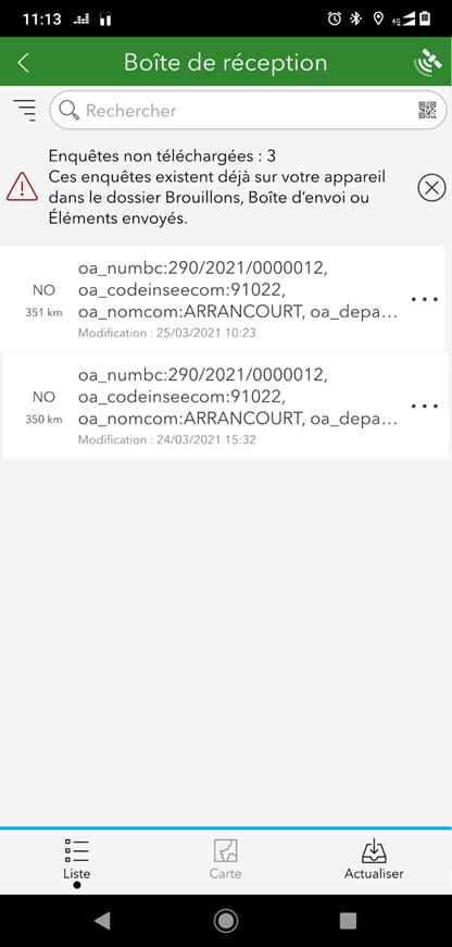

Hello,
Is it possible to customize the fields displayed in the 123Survey inbox?
Indeed, the display is not very ergonomic by default.
Thank you.

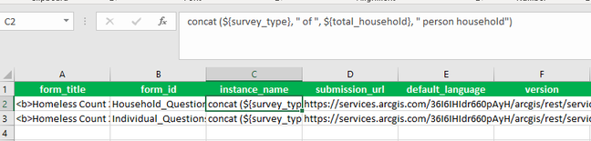

In the settings tab of your form you'll see a column called 'instance_name'.  This is where you can customize the inbox appearance.  Here's a couple examples:
This one is using the surveyor's name as the instance name.
This one combines the responses from 3 separate fields.
I hope this helps!
