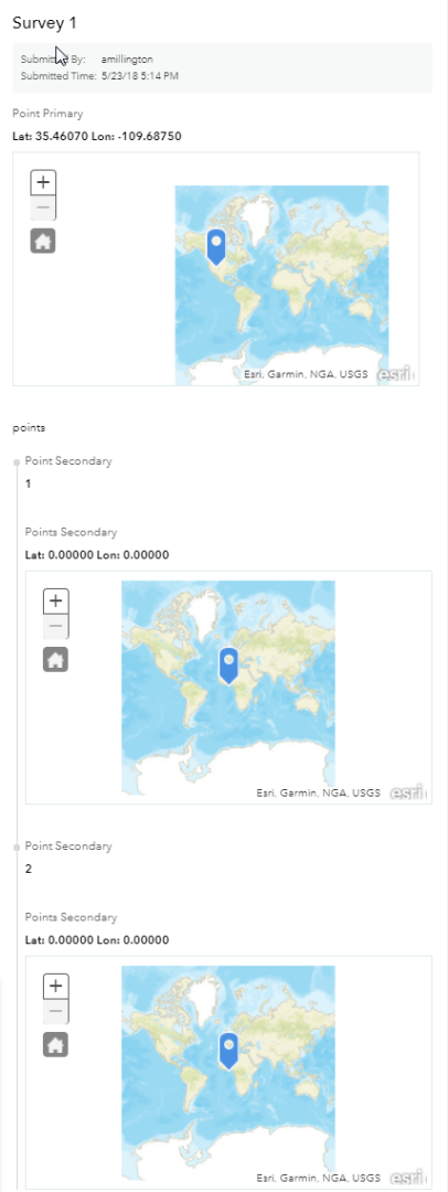

I have developed a Survey123 survey with a primary record which includes a geopoint, and related records (1-n) also containing a geopoint.  In all cases I move the marker to exactly where I want location recorded.
The location is recorded just fine in the primary record, but in all related records no location is recorded.  The  location is lat: 0.0000 and lon: 0.0000.
Here is a simplification, for your perusal:  What am I doing wrong?
Spreadsheet entry.
Result in Survey123

Hi Anne,
This is a known issue, geopoint questions inside a repeat do not automatically get a location when loaded or on adding a new repeat record. We have an open issue for this in our backlog, and I have added your comments to the issue.
In the meantime you need to manually press the GPS location button to apply the current location to the geopoint question.

Hi Phil,
I tried pressing the GPS location button, and it moved the marker and registered in the survey form, but the end result was the same once submitted.
Do you think this issue will be addressed in the near future? I will need to come up with some kind of workaround, as having multiple sub-locations related to a primary location was a real point winner for the application. I guess users could record their sub-locations with a dedicated gps device and add the values in later, but that adds a step. Since we don’t require a high degree of accuracy, having this taken care of within the application is quite a boon. We can always go with one location for all observations within a certain area for a while, and still realize value from the survey app.
