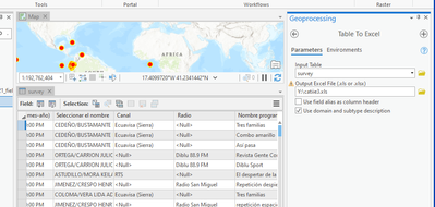

I used Tool box (Geoproccessing TABLE-TO-EXCEL.
Please don't forget to check (use domain and subtype description) and is DONE!!!
Good luck.
