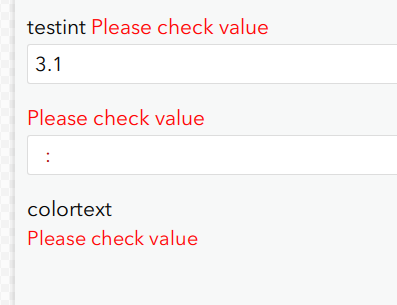

Hi Doug, it looks like you got the "please check value" text to change to red. If there no way I can have two calculations for one row? I would like to calculate my value and if it is below 3.0 change it red. Is it not possible to use multiple calculation functions?
DougBrowning
MVP Esteemed Contributor
Yes you can.  Just change the testint field in my sample with you calc.
