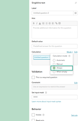

  • If you are using the web designer, please follow the screenshot below.

Sorry for the confusion, I understand the issue now. It is caused by the new calculation mode feature.
Please update the calculation mode to "always" for the question that has an input mask set.
  • If you are using Connect, put "calculationMode=always" in "bind::esri:parameters".
The calculation mode controls when calculations are performed in questions and is set to "automatic" by default. When the source question changes, this mode can prevent recalculation in the target question, which means your hidden question cannot receive the updated value.

GabrielaReyes
This resolved the issue, thank you!
