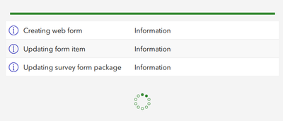

Now that I've made a minor change to my survey, it won't re-publish. The loading symbol goes on and on and never actually reaches the publish completion. I have determined that the moving form to another folder has caused this issue... Since the original folder it published to is deleted, how can I fix the issue?

It seems like swapping out the folder ID for ownerfolder doesn't fix the issue for me either, the publishing process still is stuck on the loading page.
