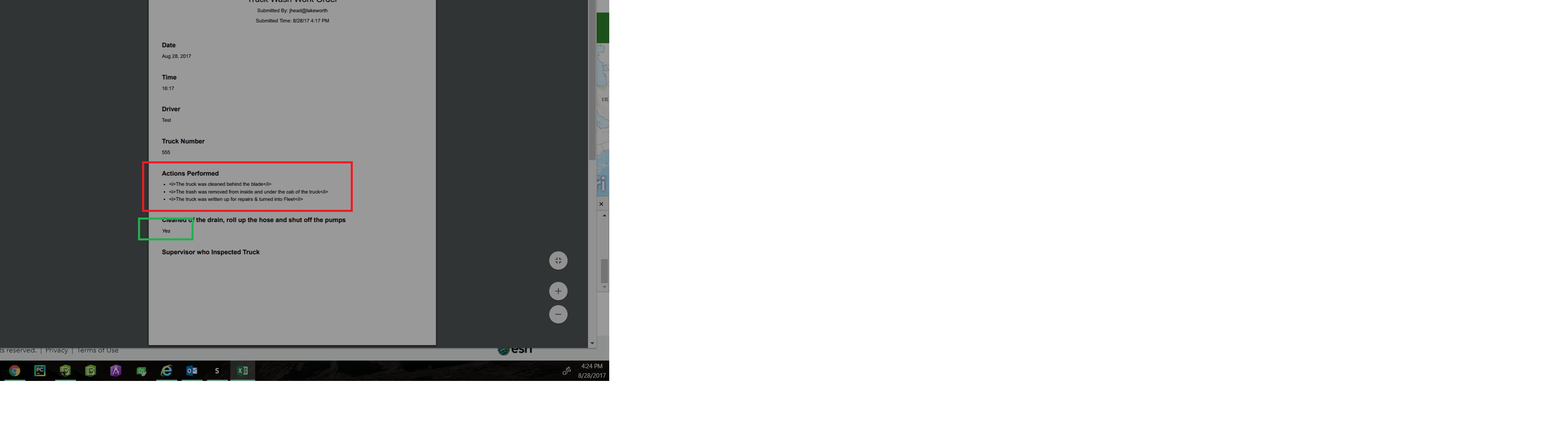

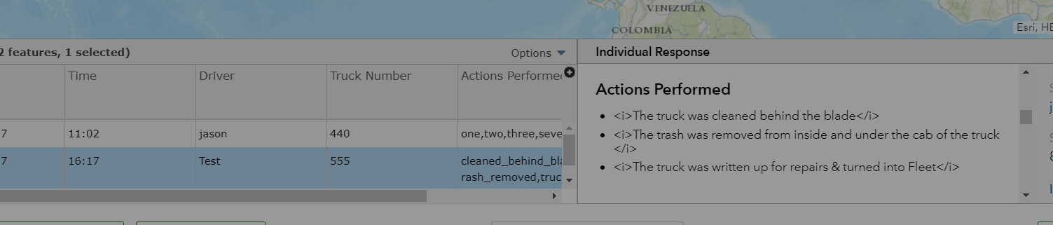

When viewing the data submitted in a survey.... the results show the html tags used. see image below....
how do I disable this or is this a bug?

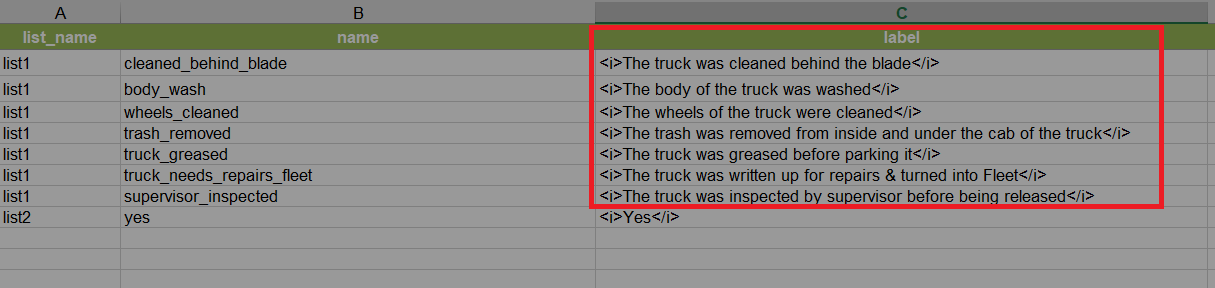

However not all the fields with html tags are being show with the tags. see the xls form.... circled in reg (shows the tags)
yet the list below it does not (see other image value circled in green)

Hi Joe,
Currently, the Survey123 website doesn't expect HTML to be embedded in the answers provided.  I've added your experience to the development issue concerning this.

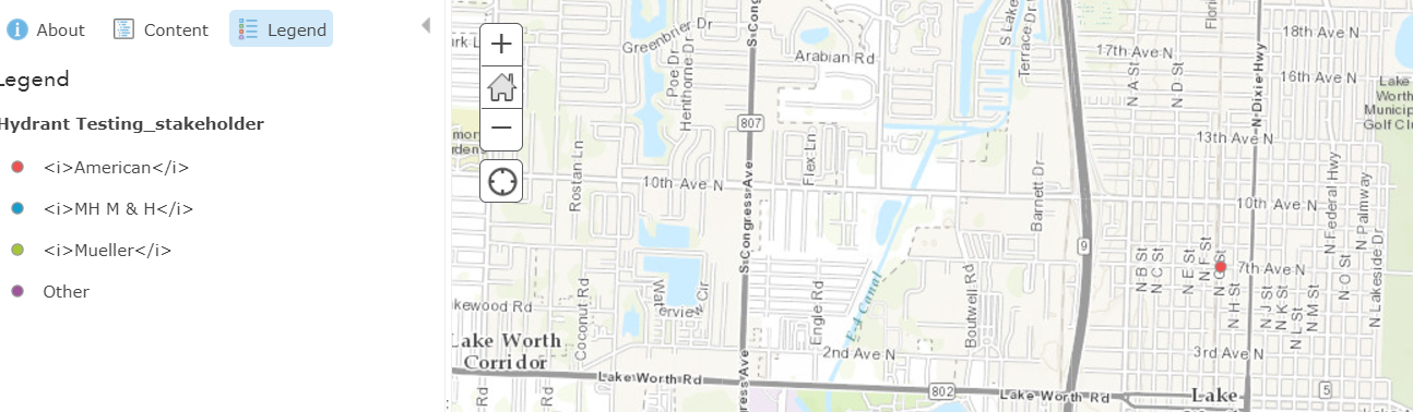

The html tags are also displayed in the Feature Service in AGOL, which means even though I want my survey styled nicely I have to remove my tags because I dont want my clients to see the tags in reports/web maps.
