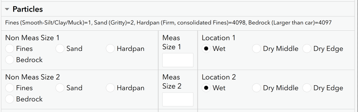

You can do this by setting a width on the begin group line then vary the size of each field inside that group.
Here I have begin group as w3 then some lines are w1 which take 1/3 the line and some are w3 which take up all the line.  Anytime you add up to the max it goes to the next line.  If you did say 5 you could mix 3 and 2.
This one is w9 group with two w4 and one w1.
