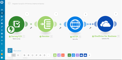

To add a bit more to this, here is a screenshot of an Integromat flow hat uploads all attachments submitted through an image question with multiline appearance. Note that an Iterator module is used to loop through all attachments sent, so they can be uploaded to OneDrive.

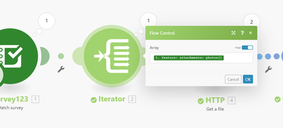

The iterator is configured to target the Attachment URL array:

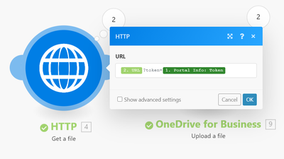

When downloading the attachment using the HTTP Get a file operation, do not forget adding the token a the end of the URL if you are working with a private feature layer.

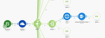

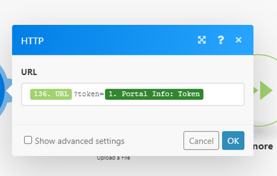

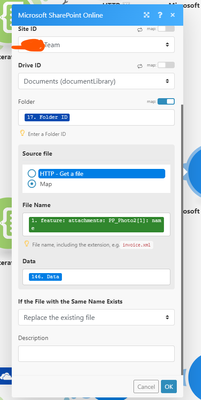

RoryBennison
Hopefully these screenshots help, this is what we use for multiline images in our surveys
