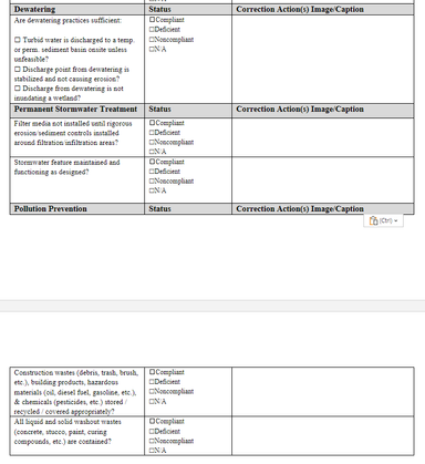

The next grouping of inspection questions is where I am having trouble developing a form/picking software. The inspection form that is currently being used has six categories with a various number of questions in each section (between 1 and 6 questions). For each question, we have the same condition checkboxes to be filled out (compliant, deficient, noncompliant, NA) as well as a picture/caption.
Initially, I thought that the repeat function could work well in Survey123 Connect to repeat the condition checkboxes and picture/caption to each question. However, in the repeat, I would also want the category and question so that during reviews and in the development of reports, I can format it similar to how it is currently being shown (see picture below).
Current Site inspection form layout. Categories in Gray, with relevant questions below. "status" is the same for each question, and each question should have the ability to attach an image/captionCurrent Site inspection form layout. Categories in Gray, with relevant questions below. "status" is the same for each question, and each question should have the ability to attach an image/caption

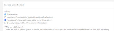

Thanks, @clt_cabq! I did give the hydrant template a look over and built a service based off of that, so far, everything is working fine. I went to try to put the feature class of locations/basic fields into field maps, but it says it can't be edited. Have you ever ran into that issue?
clt_cabq
@LeahG its been a while since i worked with field maps i can't recall if there is a setting you need to make there in order to make a layer editable separate from other places. Have you made sure the editing settings are correct in the layer settings page?
