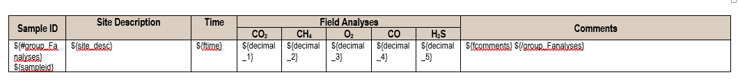

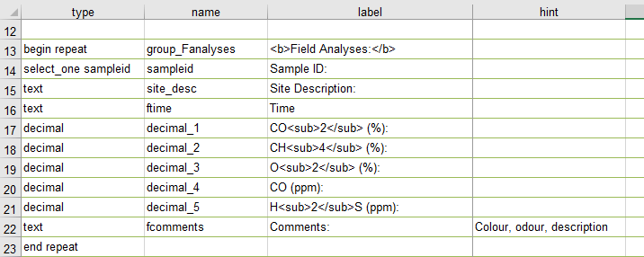

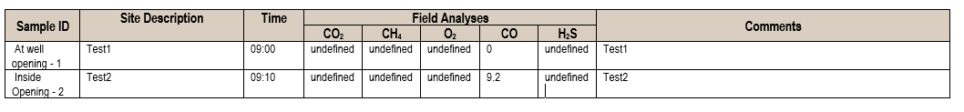

I am receiving "undefined" in my custom output file even though these sections were filled in on the survey.
Picture of survey excel:
Picture of custom output template:
Picture of what I'm receiving:

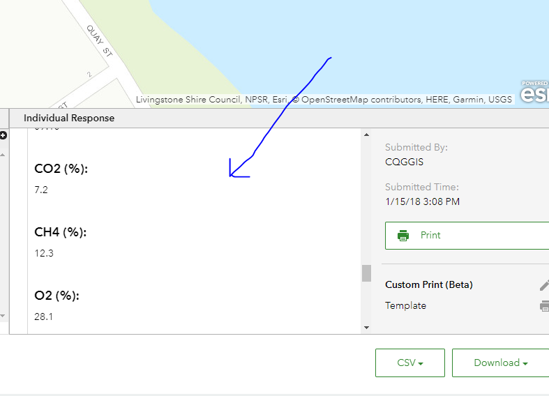

In the survey the CO2, CH4, O2 and H2S inputs were filled in. Interestingly enough they seem to work in the default template on the site, however if I download the default template and use it as a custom template it returns "undefined".
