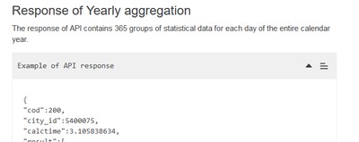

Open Weather API sounds like it can pull the last year (EDIT: sorry, they have yearly, monthly, and daily APIs). And their definition of "max" for "precipitation" sounds like it should count.

Thanks! I had come across these actually, and I've gotten the pull to work, but really the issue is that I don't want a daily aggregate, but an aggregate of the previous 24 hours, which is of course unlikely to be a single date (which is how I would structure the API call based on what I read in Open Weather's documentation).
