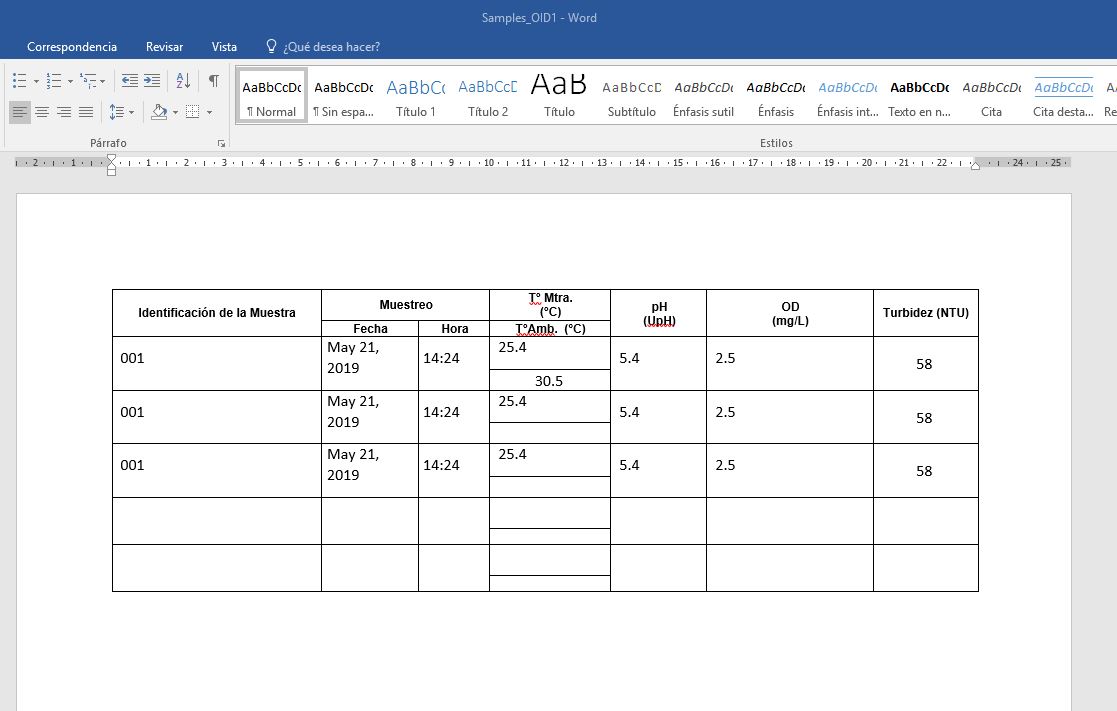

Is there any way I can select a group of records and print them in only one Survey123 report?
In my Survey123 report I have a table and I want to print one record per row inside the same table, as you can see in the following image:
I was trying to accomplish this, but the default option is to print one report for each record.
