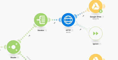

The array I'm passing to the iterator is the repeat itself (field_observations)

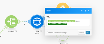

Then I run the scenario once by triggering the webhook with a submission, so that now I can see the structure for the next module.  Here's where I'm grabbing the URL using an HTTP GET module

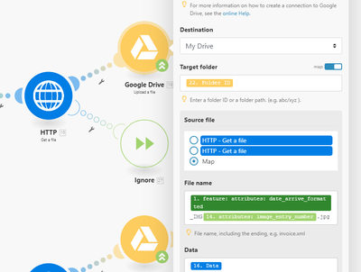

And uploading each photo to google drive, while renaming the photos. Note that in my scenario, I have to include the file extension when renaming.
