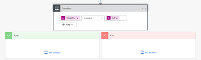

And then use that in a Condition similar to this:
When the repeat is empty, it will do one thing, and when it contains data, it will do something else.

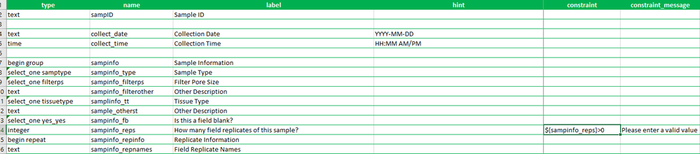

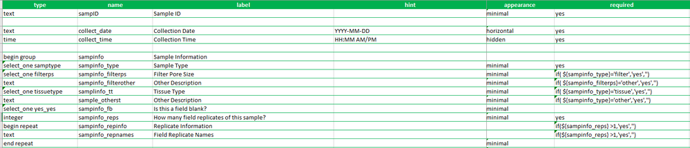

Hello here are the screenshots of the XLSX. Screenshot 1.pngScreenshot 2.pngscreenshot 3.png

A quick glance at the screen shots seems to indicate that:
  • ${saminfo_reps} is required and must be >0
  • ${saminfo_repinfo} is required if ${saminfo_reps}>0 and the number of repeat items is equal to ${saminfo_reps} (which is a positive integer).
Given that, the ${saminfo_repinfo} array should theoretically never be null, meaning your flow should at least get beyond that point. But, that obviously isn't the case. If you could attach the actual XLSX, I could recreate this.
(Side note, but it looks like you can just make ${saminfo_repinfo} required rather than conditionally required)

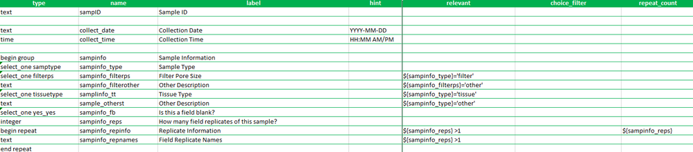

Here is the XLSX, thank you for your help!
abureaux
MVP Frequent Contributor
Had a look. Didn't clue in right away, but seeing it "in person" helped. The issue is that the repeat only appears when a number >1 is entered. That means the user can enter 1, submit the form, and your described Power Automate issue will occur.
