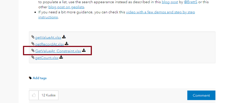

In the Tricks of the Trade blog you looked at, there are a handful of XLSForms at the bottom (right before the comments section). Download the GetValueAt_Constraint XLSForm
