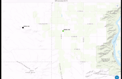

This is what we do with up to 15 forms related to the main parent.  The trick was to use Field Maps as the base.  This actually works out well since Field Maps is spatial it is great for crews getting to the location.
We preload all the sample locations they are to visit with all the important attributes.  In the popup of these we have launch links that open the different 123 forms sending several fields over to dynamically change the form for that site and pass over the relationship key.  This way all the sub forms are related back to the main form.  We do NOT use globalid for the relates, well its still there we just have a second related id that we pass back and forth.  If you ever export or import your data around globalid falls apart on you fast.
In another project we even fill out a site visit related record in Field Maps and add some info like measurements of the site then use arcade to calc some numbers and a on the fly, and an ID that uses the current date, then we use that to send to the form.
I did a big write up on this awhile back here  https://community.esri.com/t5/arcgis-survey123-questions/mapping-with-survey123-within-a-polygon-or-...
I know this is 2 apps but Field Maps is good with well maps and 123 is good for forms so they work really well together.  Works slick.

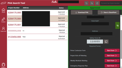

  • All projects start with our Project Hazard Assessment (PHA) form which staff fill out in-office. It contains numerous options and may result in up to ~15 extra forms needing to be filled in.
  • Just this year, I have begun to strip out all the project detail fields from these "related" forms and replace them with a single "Safety Form ID" field which will relate back to a single PHA.
  • Related forms can still be completed in the field (where needed). The field staff just need to know their Safety Form ID. When back in internet range, the forms will send off and be automatically linked to that specific PHA via the ID.
  • I created a Power Apps app to manage PHAs and dynamically show links to related forms so office staff can jump directly into a specific related form (and auto-fill in that Safety Form ID). I also send an email with quick links. These two options are basically replacing Field Maps in my case. PHAs don't always have spatial data, and the related forms are a mix of in-office and in-field forms, so this set up is considerably more convenient.
