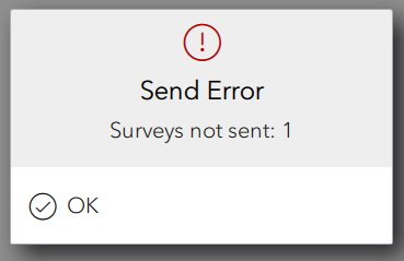

The Problem... when I go to submit it seems to upload the survey contents and attachments but then says the following and the survey remains in the Outbox.

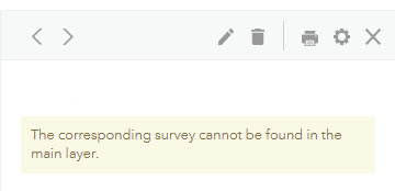

Another clue, when I have the Form View active (i.e. it shows the selected data in a rudimentary form), and I select a inspection related record, it gives me following error:

Based on your description, there are a few things that would help diagnose this issue:
- Create a log of the submission attempt - that will have a more detailed set of information about the failure to submit a record
- Based on the layer error message, you may want to check the table names, in the layer listing, the in the relationship definitions and the XLSX file, to make sure that everything matches.
This might be better addressed through an Esri Support call, as this may take some interactive troubleshooting, than via the Esri Community.
