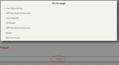

DougBrowning
MVP Esteemed Contributor
Yes if you tap the 1 of 7 page number you get a list.
This does not work for repeats yet please upvote this  https://community.esri.com/t5/arcgis-survey123-ideas/ui-to-move-to-any-repeat-for-survey123/idi-p/93...
You can also long press the arrows and it will go all the way to the end or start.  Note this trick works on repeats also.
Hope that helps
