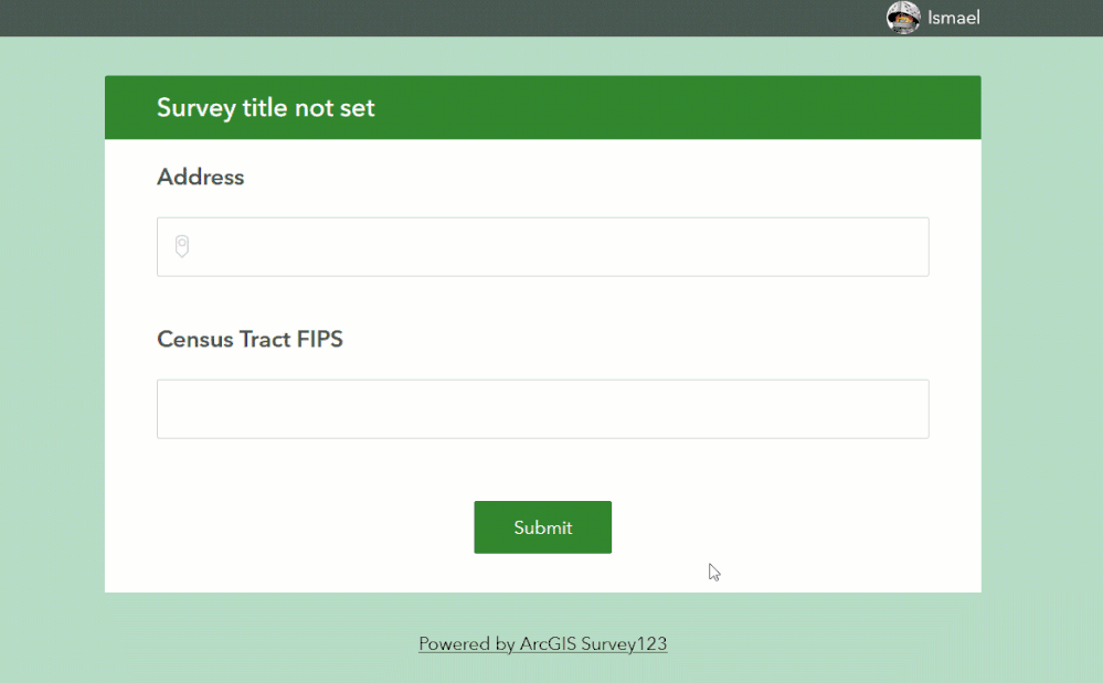

Here is an XLSForm showing how to do it for the web app using pulldata("@layer"). As described in the Early Adopter documentation, Survey123 Connect does NOT support this yet, but if you publish the survey and test it in the web app, it will run fine. It uses the 2020 Census Tract from this layer of the Living Atlas.

Yes. This is possible, if you have a layer with the census polygons.
If using the Survey123 web application, check the pulldata("@layer") section in this blog: https://community.esri.com/t5/arcgis-survey123-blog/survey123-april-2022-now-available-in-beta/ba-p/...
The pulldata("@layer") syntax allows you to do a point in polygon query against your own layer. It is in Beta at the moment, but we have deployed the code already in production, so it is easy to give it a try.  We plan to make this generally available and supported in September this year, although some people are already using it in Beta.
You could also do this with a custom JS function, which has been supported for a while.  Or even a web hook to automatically populate the census tract once the data has been submitted.

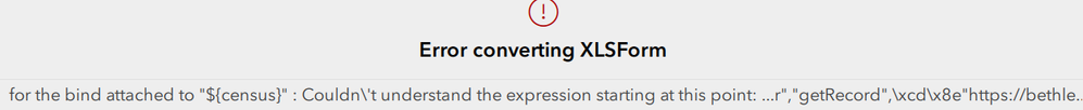

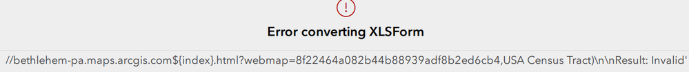

Thank you for the help! I am running into an error when I try to update my form with the suggested calculation. I am using the below calculation
pulldata("@layer","getRecord","https://bethlehem-pa.maps.arcgis.com/apps/mapviewer/index.html?webmap=8f22464a082b44b88939adf8b2ed6c..., USA Census Tract)
I am receiving the attached errorScreenshot 2022-07-08 144503.pngScreenshot 2022-07-08 144537.pngScreenshot 2022-07-08 144602.pngScreenshot 2022-07-08 144622.png
I cannot figure out how to make this work. Any assistance would be very greatly appreciated!

JoshOsowiecki
@IsmaelChivite Worked like a charm, thank you!
