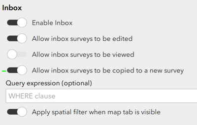

Katie_Clark
MVP Alum
Apologies, Doug. I answered my own question - I hadn't noticed this option before but now I see it right in front of my nose...
One of those days, I guess.....thanks for your time.
