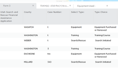

Unfortunately no. I republished with Connect 3.13.251 (the most current version) and tried all three scenarios (Search/Rescue, Training, and Equipment). I entered values in for every available field and the form submitted for me. I also tried the reverse by only entering values for required fields and it still worked. Below is a screen cap of all six tests in my portal.
I recently logged bug with Esri regarding integers/decimals used in repeats, but that doesn't seem to be the case here. Sorry, wish I could help more, but the problem doesn't want to replicate for me! I suggest you try Esri tech support and jump on a screen share with them to demonstrate the problem. Then they can take your files are attempt to replicate the issue in their environment. Actually seeing the problem in action may help shed some light on it.
