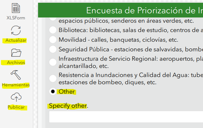

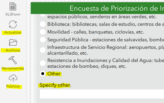

I am having trouble with an select_one or_other question.  How do I get the other to show in Spanish?  I tried setting the default_language to Spanish (es), changed connect to Spanish, but I can't figure out if it's possible to change the "Other".  It changed connect to Spanish, so I feel like that is something.
I know the select_one or_other data type can not be used within Multiple Languages survey, so perhaps this type is only available in English.

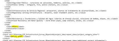

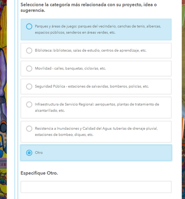

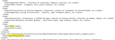

It appears editing the xml directly might be a work around, for single level non-English surveys.
Modifying to Spanish
It appears you have to do it for each or_other.
Looks like it works!
