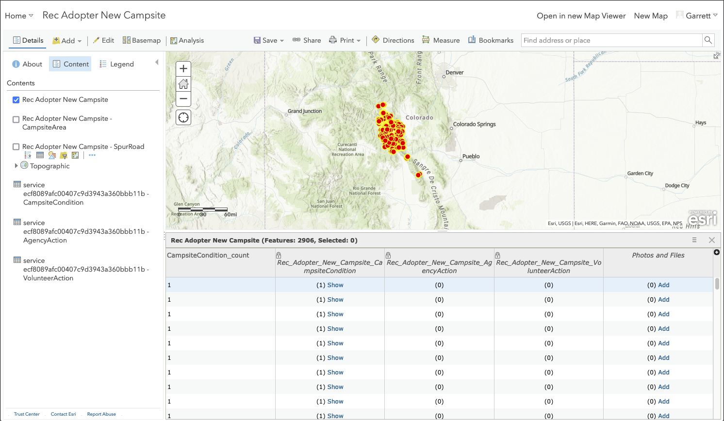

I have a group of three surveys linked to one hosted feature layer (point) via the GlobalID of the feature layers and ParentGlobalID captured via Field Maps when users click on the points in the field. This was all set up using one large survey with repeats.
I am trying to create some online maps with the data for each of the surveys linked to the points to be used in a data dashboard and web application. When I open the feature layer in Map Viewer I can see which points have associated tables based on the three surveys as below. Note, I have opened in Map Viewer Classic because I thought that I might need to join the tables to the feature layer.

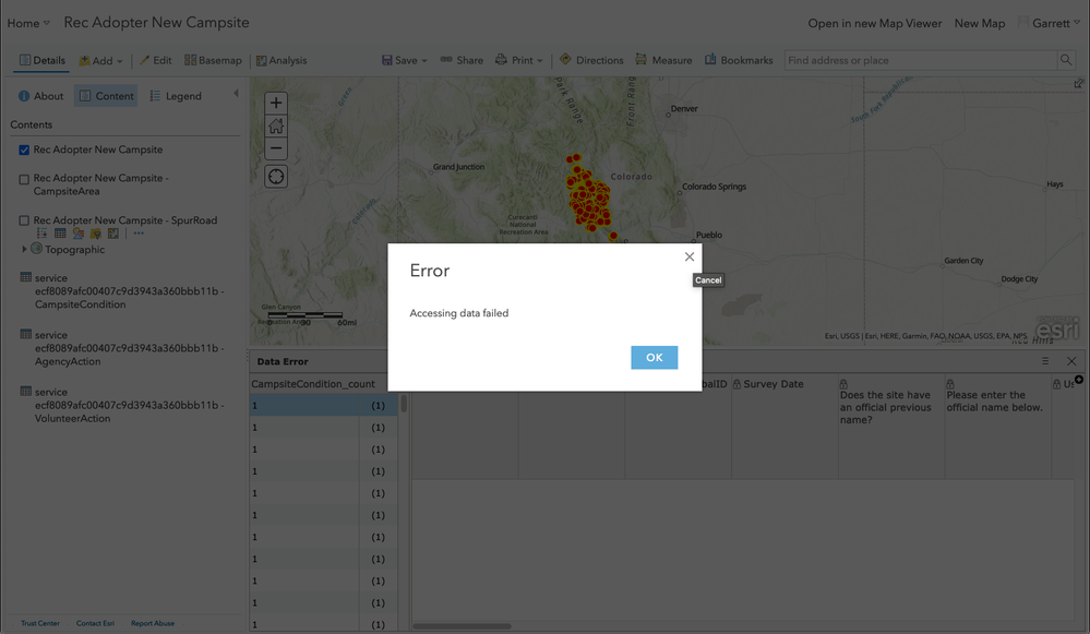

If I click on Show I get the following error:
Screen Shot 2022-06-19 at 4.33.08 PM.pngScreen Shot 2022-06-19 at 4.33.08 PM.png

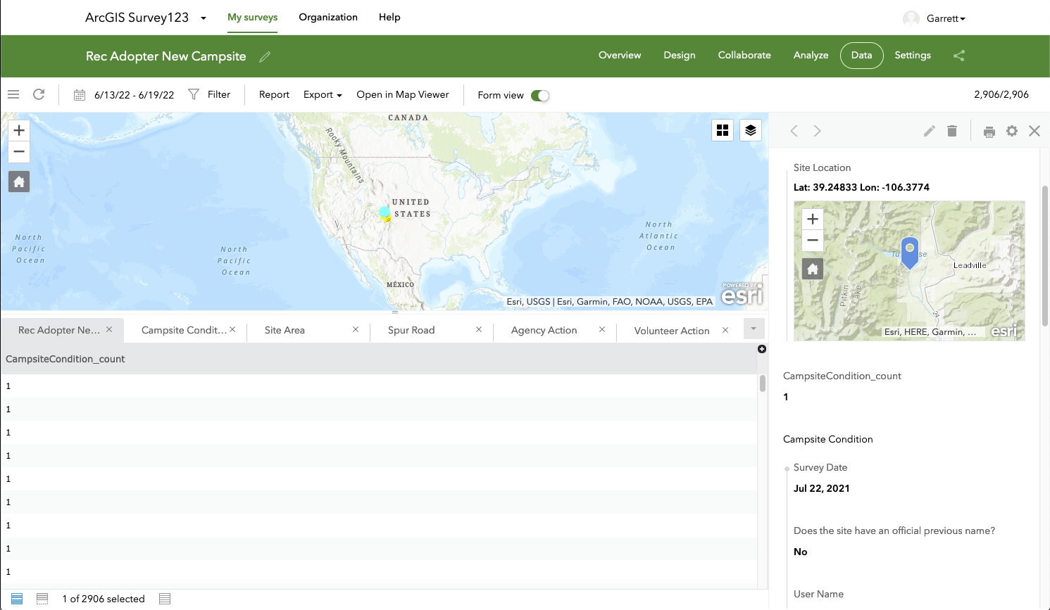

But, if I look on the Survey123 website, I can see that the records are there and everything seems to be playing nice together:
Screen Shot 2022-06-19 at 4.34.43 PM.pngScreen Shot 2022-06-19 at 4.34.43 PM.png

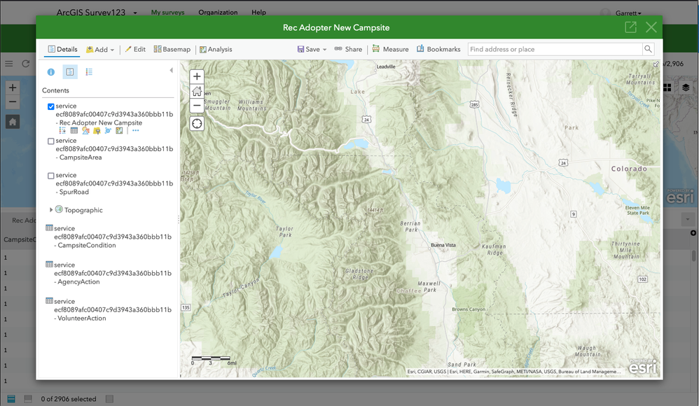

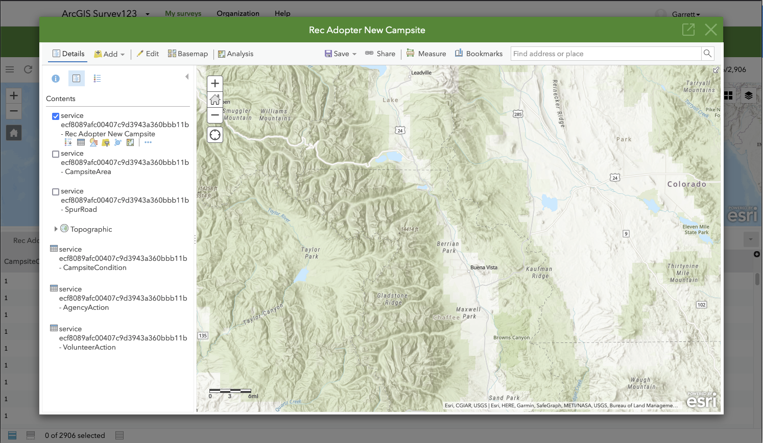

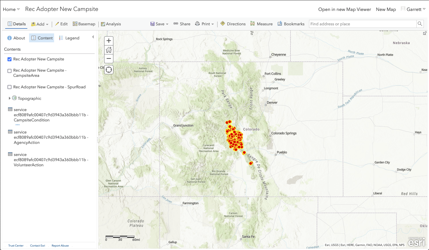

But then I notice if I try and open the data in Map Viewer from the Survey123 website, nothing shows up:
Screen Shot 2022-06-19 at 4.53.39 PM.pngScreen Shot 2022-06-19 at 4.53.39 PM.png

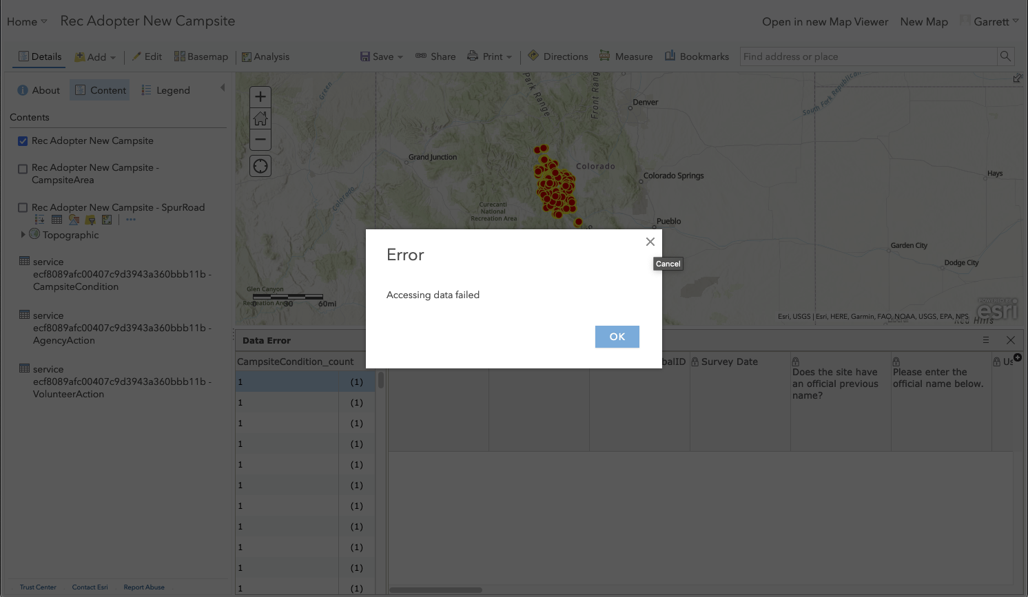

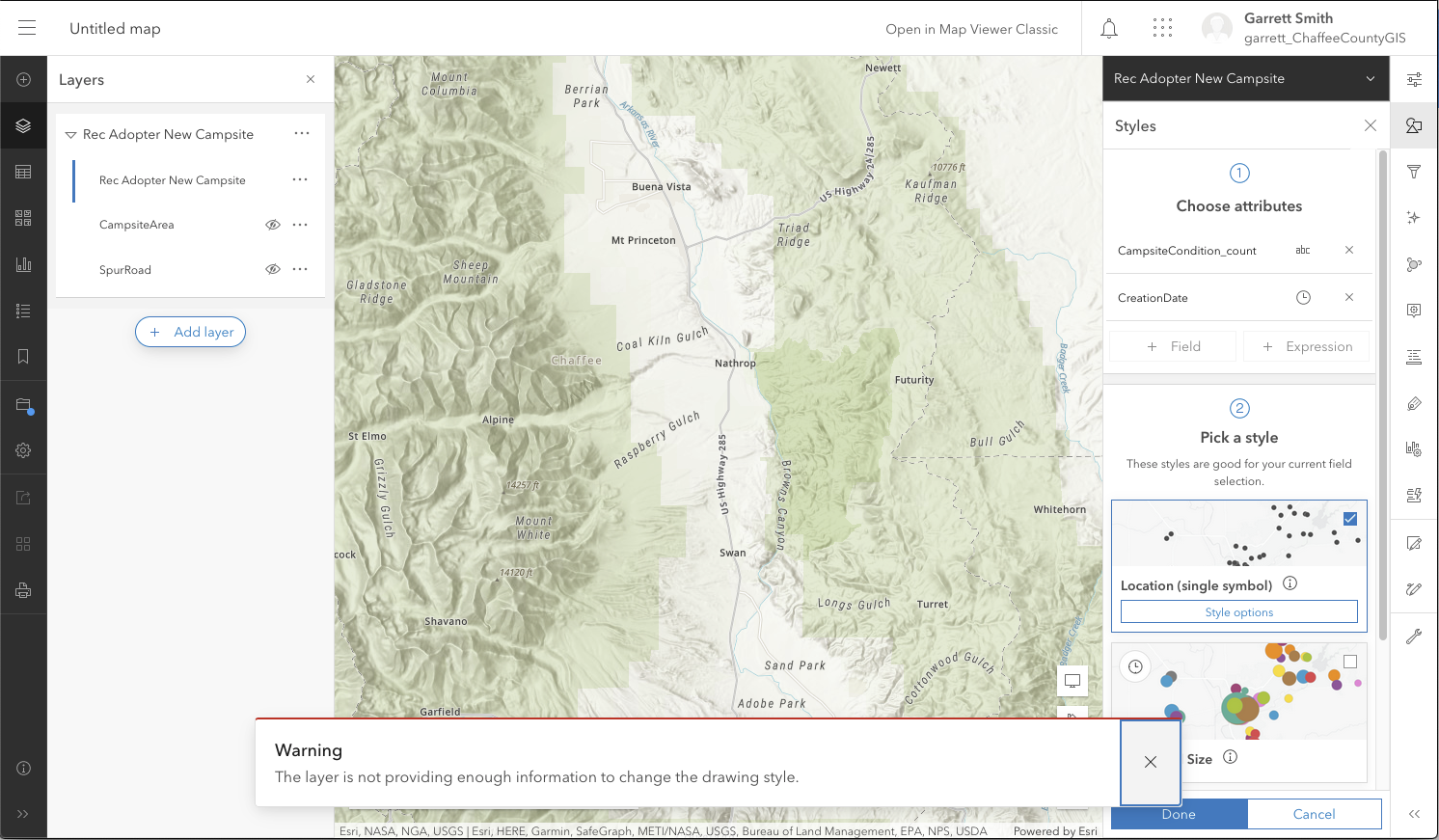

I tried to open it in new Map Viewer and get a weird warning message:
Screen Shot 2022-06-19 at 4.56.37 PM.pngScreen Shot 2022-06-19 at 4.56.37 PM.png
Does anyone have any idea what is happening here?

Instead of opening the point layer, I opened the entire feature layer in Map Viewer Classic. The points and tables were present and I performed a join to create view feature layers for each of the tables. People have collected data after performing this task and the points are updating on their associated online maps.

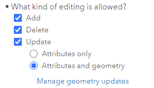

If you check the settings for the feature service is Update or Delete enabled?
If Update and Delete are disabled then Query will be disabled on the feature service. With query disabled the map viewer will not be able to access the data.
