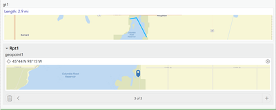

A geopoint question can only handle one point, there is not an option for multi-point geometry. Using repeats gets you multiple single points,i.e. 1 point per repeat. You also can't reference a point in a question resulting from the answer to that question in a previous repeat as it results in cyclic dependency.
Here is kind of a workaround type solution that might suffice.  Add a readonly geotrace question right above your repeat.  In the calculation field add sum(${<your_geopoint_question>}).  This will give you a path (line) of where your previous collections were taken that can be referenced prior to collecting a new point.  If you already have a geo type question in your main form, make sure to null the geotrace.
hopefully that is closer to what you want.
The other not good option I can can up with is, and would only work online, would be be have users submit after each point collection.  Then use the repeat layer to make a web map to reference in the geopoint question.  The map could then show all previous points and user would add a single new point with each submission.
