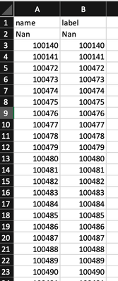

This is what I see in the update for Survey 123 field app:
  • External select choice filters can now use name values as numbers.
The reality:
I had external choice list for the survey (Nan string value and numbers):
Worked fine like this, and still works in Connect (I have not updated it):

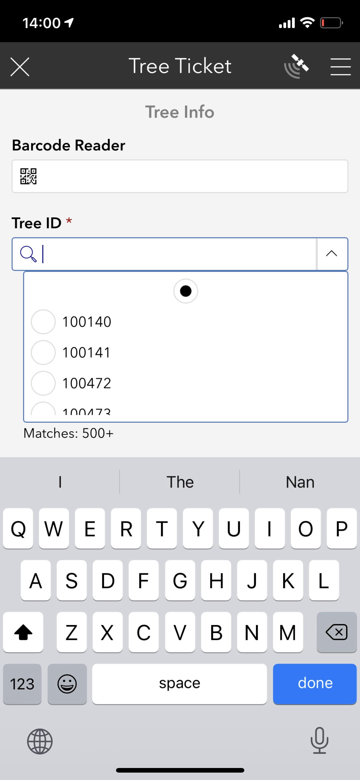

This is what is happening in the field app (instead of Nan I have selection mark):
Thanks,
Yulia

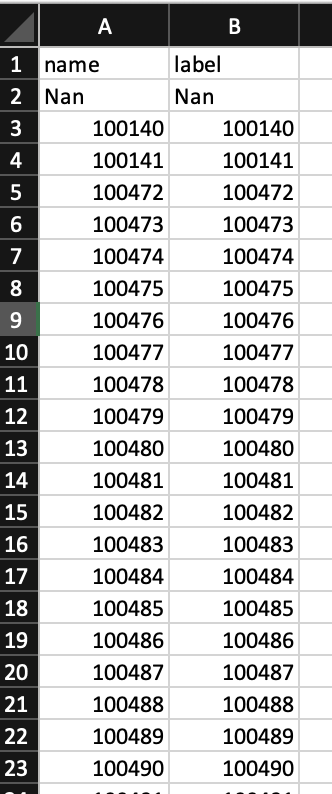

Update: Changed "Nan" to "Not Found" and it now displays in the dropdown. Has "Nan" become a reserved word or something?
YuliaMamonova
Yes, but it worked fine previously so it confused me. The data is coming from a third party and is pulled into csv, so I asked them to change it from Nan to smth else, and now it's all good. Thank you.

Hi Yulia,
As described in the 3.12 What's New blog post, the list processing has changed to be more robust and performant.  If you wanted a value nan in a sequence of numbers, you would need to ensure that is in double quotes in the CSV file

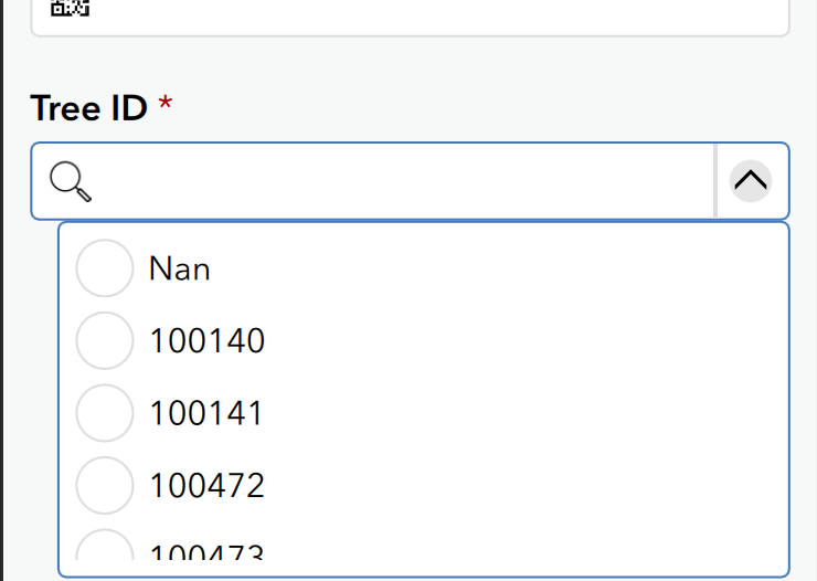

Update: I have updated connect and now external choice list shows the same behavior as the field app. Tried recreating the csv, but still only numeric-like values are showing up in the dropdown. Please suggest!
YuliaMamonova
DanPatterson
MVP Esteemed Contributor
nan = > n(ot) a n(umber)
NaN - Wikipedia
... sort of retired...
YuliaMamonova
JamesTedrick
Esri Esteemed Contributor
Hi Yulia,
