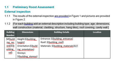

I'm trying to test a template I'm building, but when I upload it I get an error related to some text outside of my tags.
Error: An error occurred when checking the report template. The tag beginning with "Preliminar" is unopened. The loop with tag "" is unopened.
It's telling me the error is related to the title of the document?? Surely this does not need to be in a tag? Is this possibly an error related to the use of headings formatting in word?
I've attached the file!

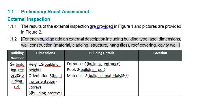

You open your repeat with $#{building_record}, but I believe it should be ${#building_record}, with the hash tag inside the brackets.
Let me know if that fixes it!

BenSiggery
Thanks so much! Doh! Silly mistake, but really strange how the error message translated it.
Katie_Clark
MVP Regular Contributor
Yeah, sometimes they can be pretty cryptic. At least it was an easy fix! 🙂
My understanding for the way it was worded is that it detected that you wanted to close a loop with ${/}, but since the loop opening wasn't formatted correctly, it just defaulted to the beginning of the document.
