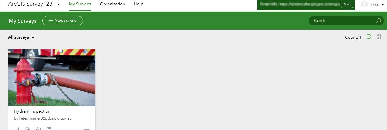

I've managed to publish a demo survey from Connect to the portal.
I can login to the survey123.arcgis.com and I can see the survey on my Portal.
But as soon as I get into any of the tabs it just sits there and sometimes gives errors.  Tracking the traffic I'm getting a few requests failing. That when those requests are opened independently they work.
